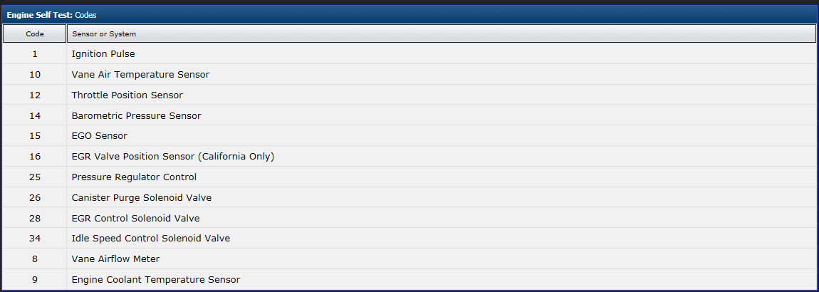

Re: Engine Self Test 1989 2.2L 4-Cylinder N/A Error Codes
Post by 1stgenWizard » Tue May 15, 2018 3:44 pm
Error Codes
