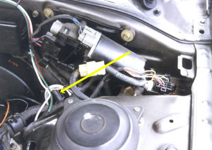

Key On Engine Off Self Test: Turn the ignition switch ON, but do not start the engine. When you're ready to start the test, ground the Self-Test Input (STI) connector. It's a red wire with a white stripe located just behind and slightly to the right of the right strut mount (See Image Below).
Key On Engine Running Self Test: Start the engine and allow it to idle. When you're ready to start the test, ground the Self-Test Input (STI) connector. It's a red wire with a white stripe located just behind and slightly to the right of the right strut mount (See Image Below).

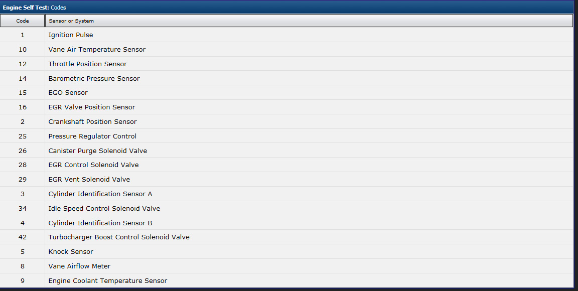

Post by 1stgenWizard » Tue May 15, 2018 3:41 pm
Error Codes
error codest89.jpg (174.62 KiB) Viewed 4101 times
