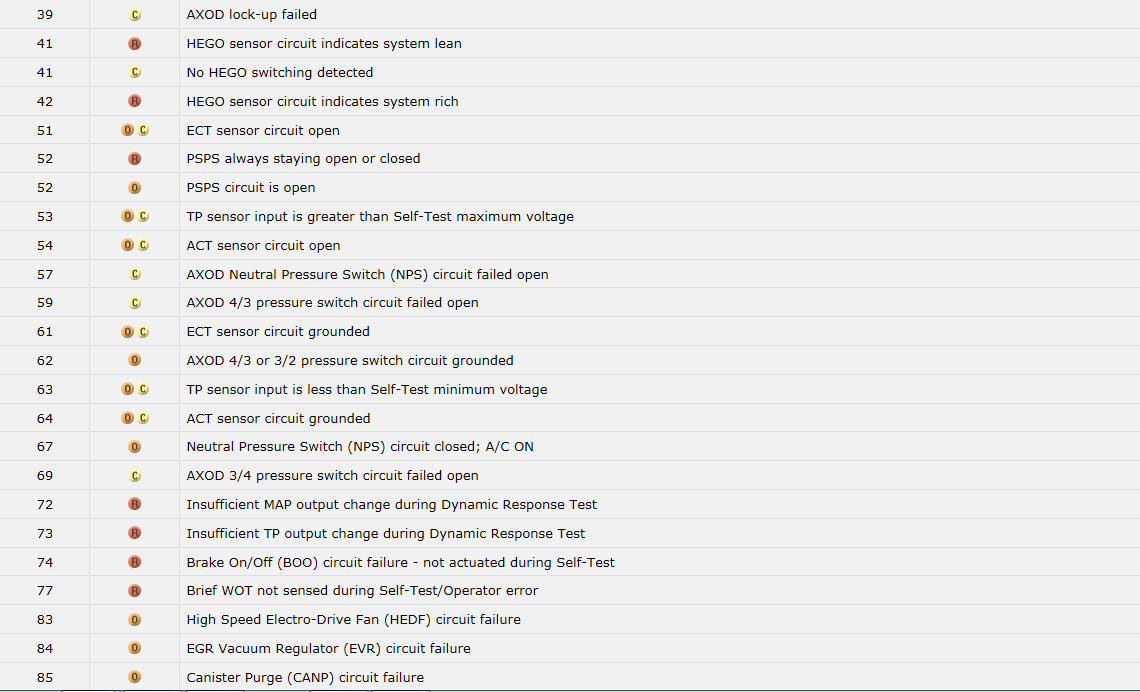

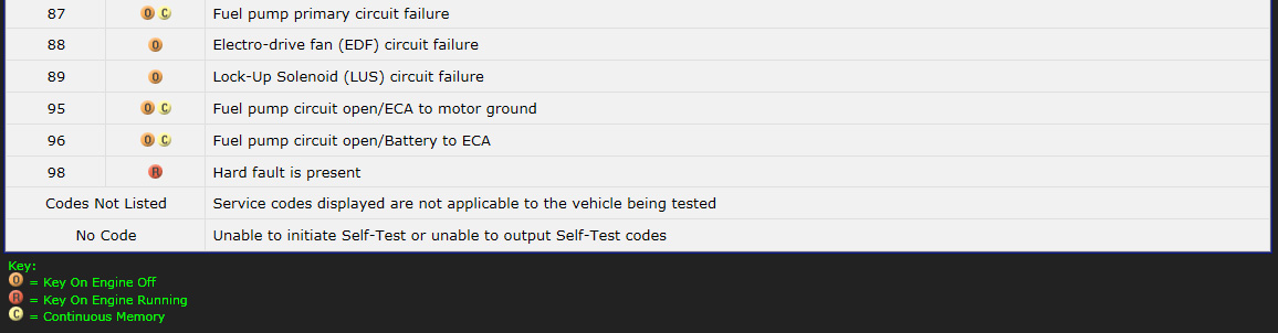

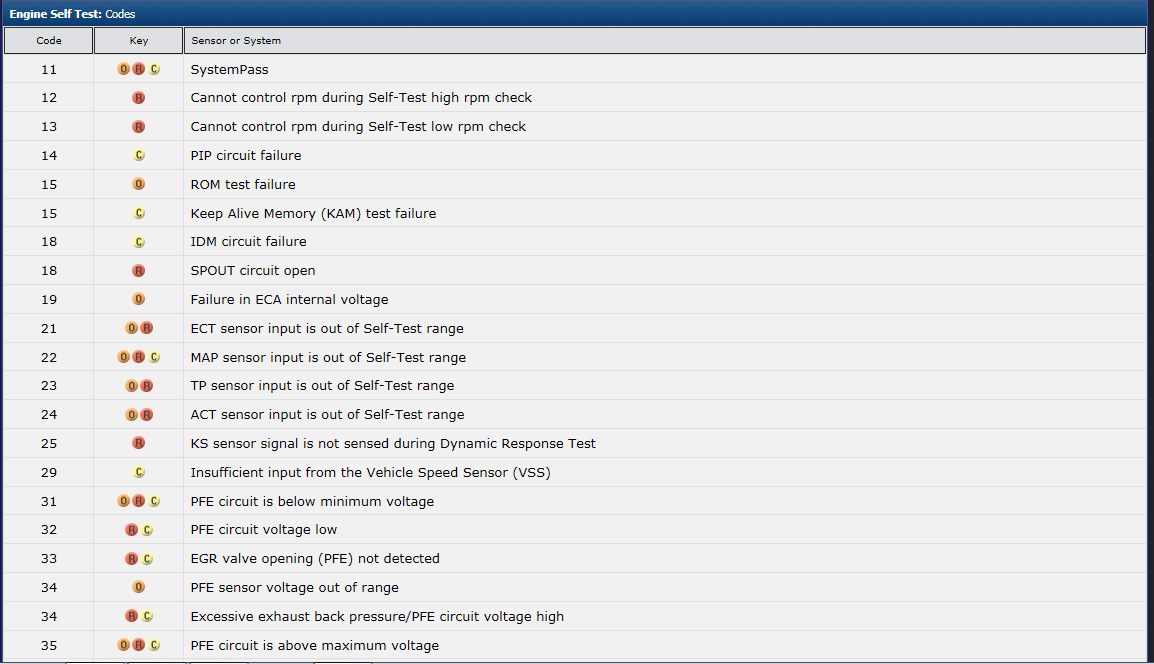

Post by 1stgenWizard » Tue May 15, 2018 3:37 pm
Error Codes
