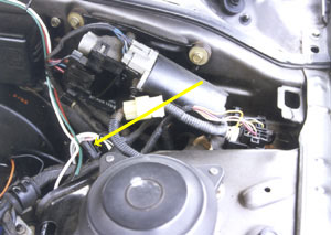

Key On Engine Off Self Test: Turn the ignition switch ON, but do not start the engine. When you're ready to start the test, ground the Self-Test Input (STI) connector. It's a red wire with a white stripe located just behind and slightly to the right of the right strut mount (See Image Below).
Key On Engine Running Self Test: Start the engine and allow it to idle. When you're ready to start the test, ground the Self-Test Input (STI) connector. It's a red wire with a white stripe located just behind and slightly to the right of the right strut mount (See Image Below).

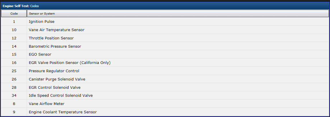

Interpreting the Codes The pulses on the voltmeter and the flashes on the MIL light translate into two digit codes. To simplify things, we'll call all flashes and pulses, pulses. There are two types of pulses. A long pulse is a pulse that lasts 1-1/2 seconds. A short pulse is a pulse that lasts a 1/2 second. These are pretty distinguishable. The long pulse represents the first digit or tens position of the two digit code. The short pulse represents the second digit or ones position of the two digit code. So, if there is one long pulse followed by four short pulses, that would be the number 14. If there isn't any long pulse, the number is less than ten and the first digit is 0. Eight short pulses with no long pulse would be a 08 code. If there is a long pulse, but no short pulse, the code is 10.
Two digit codes are separated by 4 second pause. When all the codes are displayed, the codes will repeat. As an example, eight short pulses, a four second gap, three long pulses, four short pulses, a four second gap, eight short pulses, a four second gap, three long pulses, four short pulses... repeating continuously will be interpreted as two codes 08 and 34.
Codes 8 and 34
