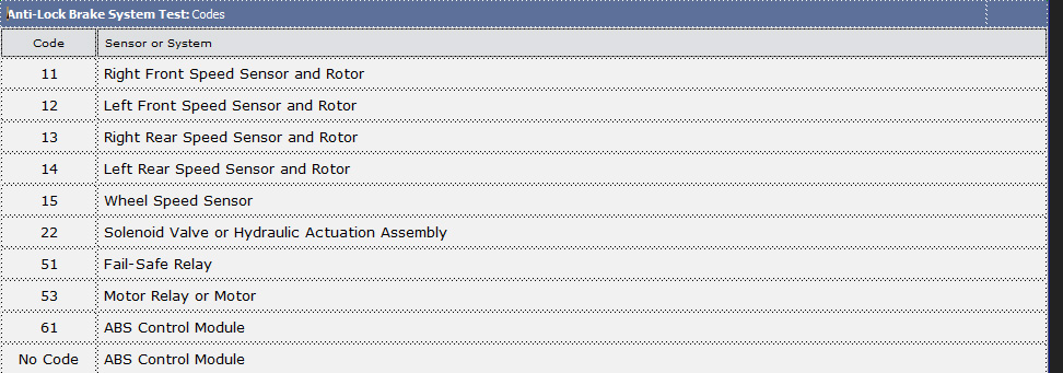

There are two ways to check for error codes:
Engine Code Scanner
If you have a Super STAR II or equivalent engine code scanner, you can perform a quick test on your anti-lock brake system to see if there's anything wrong. Simply connect it according to the manufacturer's instructions and write down the codes that appear. Codes are listed below.

Interpreting the Codes
The pulses on the voltmeter translate into single digit codes. Every time the needle on the voltmeter sweeps across to 12 volts and drops back to zero, that is considered one pulse. Codes are displayed by the number of pulses the voltmeter displays. So three pulses would indicate an error code 3. If there is more then one error code, they are separated by a longer pause.
In addition to the voltmeter, you will need to keep an eye on the ABS warning lamp during the test as well. The lamp will either flash on then off once for each code, or will stay illuminated. A flash or a continuous illumination of the ABS warning lamp will be part of determining which fault is present.
