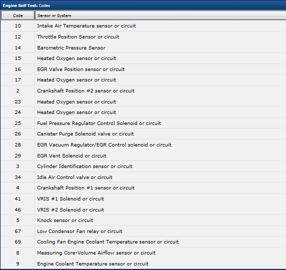

Engine Code Scanner
Analog Voltmeter
If you don't have an engine code scanner, you can perform the same test with a standard analog voltmeter. Set the meter to read between 0 and 20 volts. Find the Data Link Connector under the hood, between the battery and the left fender. Connect the positive wire of the voltmeter to the Self-Test Output (STO) pin on the Data Link Connector (see image below). Connect the negative wire to a ground.
Key On Engine Off Self Test: Turn the ignition switch ON, but do not start the engine. When you're ready to start the test, connect a jumper between the Self-Test input (STI) pin and the Ground (GND) pin on the Data Link Connector (see image below).
Key On Engine Running Self Test: Start the engine and allow it to idle. When you're ready to start the test, connect a jumper between the Self-Test input (STI) pin and the Ground (GND) pin on the Data Link Connector (see image below).
MIL Light
Interpreting the Codes; The pulses on the voltmeter and the flashes on the Malfunction Indicator light translate into multi-digit codes. To simplify things, we'll call all flashes and pulses, pulses. There are two types of pulses. A long pulse is a pulse that lasts 1-1/2 seconds. A short pulse is a pulse that lasts a 1/2 second. These are pretty distinguishable. The long pulse represents the first digit, and the short pulse represents the second digit. So, if there are three long pulses followed by four short pulses, that would be the number 34. If there isn't any long pulse, the number is less than ten. Eight short pulses with no long pulse would be an 8 code. If there is a long pulse, but no short pulse, the code is 10. If there is more than one code, each code will be separated by a 4-second pause. When all the codes are displayed, the codes will repeat.
Example; Codes 8 and 34
Clearing the Codes; Clear the PCM memory by disconnecting the negative battery cable then pressing on the brake pedal for at least 5 seconds.
