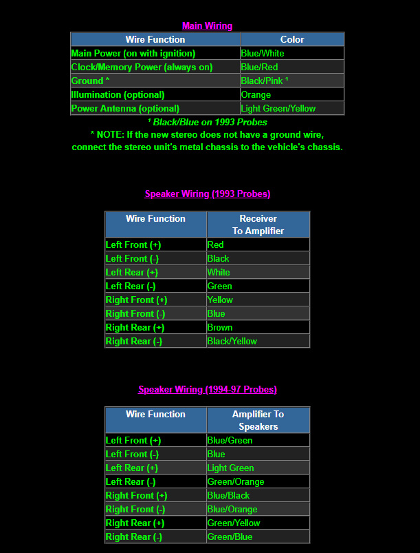

Use wiring Metra kit to wire in your new stereo, I recommend soldering the wires and using shrink tubing to cover the connections.
Use this wiring table for reference on the wiring connections.
